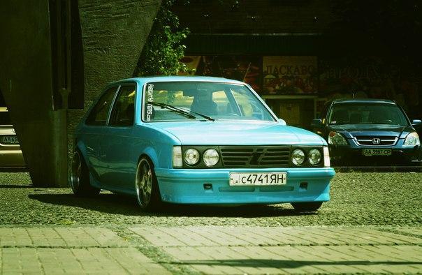

yes, of course there are a lot of pictures! I'll show all of them certainly.
Engine - C18NZ turned to 86,0 mm with XE pistons and 18E head. DBilas intake, couple of Webers 45DCOE.
ClearFist:
40er spring sits on custom coilover strut in the front. In the rear there are 90 mm dropplates and 40er spring with coilover part.
Hallo!
Sorry, that I use English again, but it will be faster and easier to tell about my friend's car. Some pe\ople, maybe, remember it by that picture:
My friend's name is Alick, he lives in Kiev, Ukraine. We have just finished rebuild of his Opel, and I want to share great pictures of it. Enjoy!
Some specs.
Engine: C20XE pistons, 18E head, Weber 45DCOE carbs, DBILAS intake, F20 getribe.
Suspension: custom front coilovers, TA-Techix absorbers, H&R -40 springs.
Wheels&tyres: 16x9 with 195/40 rear, 16x7,5 with 165/45 front PowerTech.
I would be glad to answer all the questions!
Gruss, Alexander.
