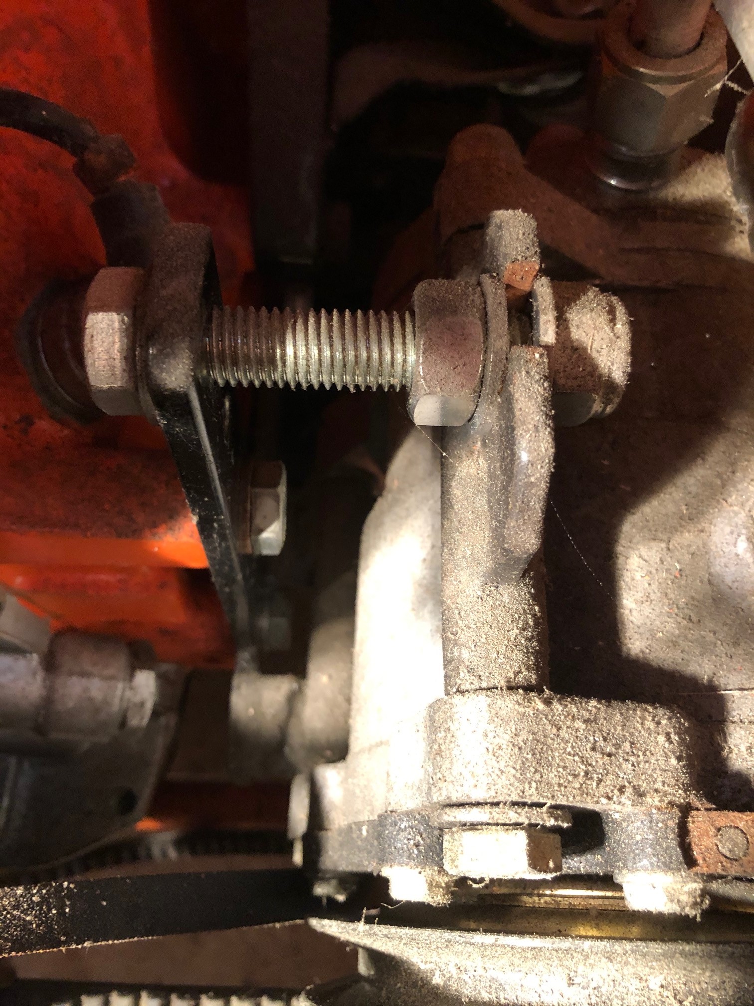

    I worked a little on the bracket to hold the A/C Compressor, and tension the belt. The yellow arrows are pointing to the mounting points on the engine, and the screws which I just put through the bracket holes. The belt will be tensioned by a simple screw, the slotted latch can pivot as well so it is always parallel to the bracket.
    The pump for the power steering will actually be mounted on the top of the compressor, but not before sometime later this week. I'm contemplating of 3D printing a bracket on Monday or Tuesday.
    Dieter
