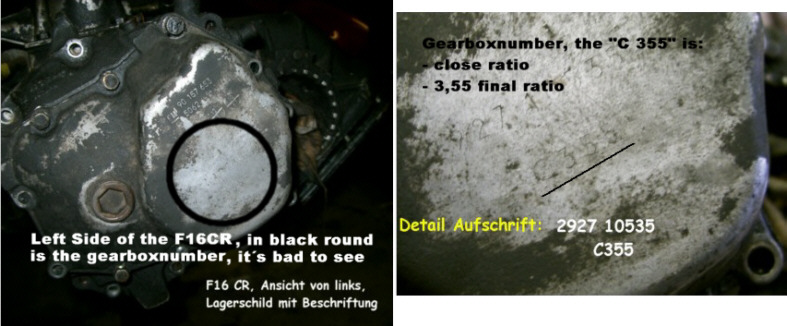

  • #37
    My english is not so good, please look at the picture. You see, where the gearboxnumber with the important information is.
    Its talking to you, which(?) gearbox in your car is.
    In the picture you see the " C 355". This say:
    - c = close ratio, w = wide ratio
    - 3,55 final drive ratio
    I hope, you understand me. Have fun!
